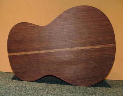

Well folks, the OLF guitar back is now glued on. I discovered there truly is a good use for rubber cement in luthery. Unfortunately, I was very tired when I did the work, and consequently I glued the upper bout to the lower bout. At least the center line was perfectly aligned! Not being sure what to do, I simply trimmed the lower bout of the back to fit the upper bout of the rim. That left me with two really great sound ports at the outer parts of the lower bout. Wow! Mistakes can make for great ideas! ! ! ! ! I reinforced the edges of the new ports with some of that great table-top epoxy coating stuff. Now the port edges are good and strong, even though they're now about 1/4" thick.
Pics to follow.....
And the other good news is that the OLF Guitar is making it's way to Chatham Massachusetts tomorrow to have Matt Gage glue on the top. I'm excited to see what he's done. We're a bit concerned because the drawing I sent him to make the top was at 3/4 scale. Hopefully he left the top trimming a bit large. So long as that's the case we shouldn't have too many issues getting it glued on to the rim.

Well, I put a new back on it this morning after Lance screamed at me over the phone last night. Too bad...I liked the ports !

Great work Don, thanks for posting the pictures of the OLF FOLK (friends of Lance Kragenbrink) Guitar.
Take a bow!
